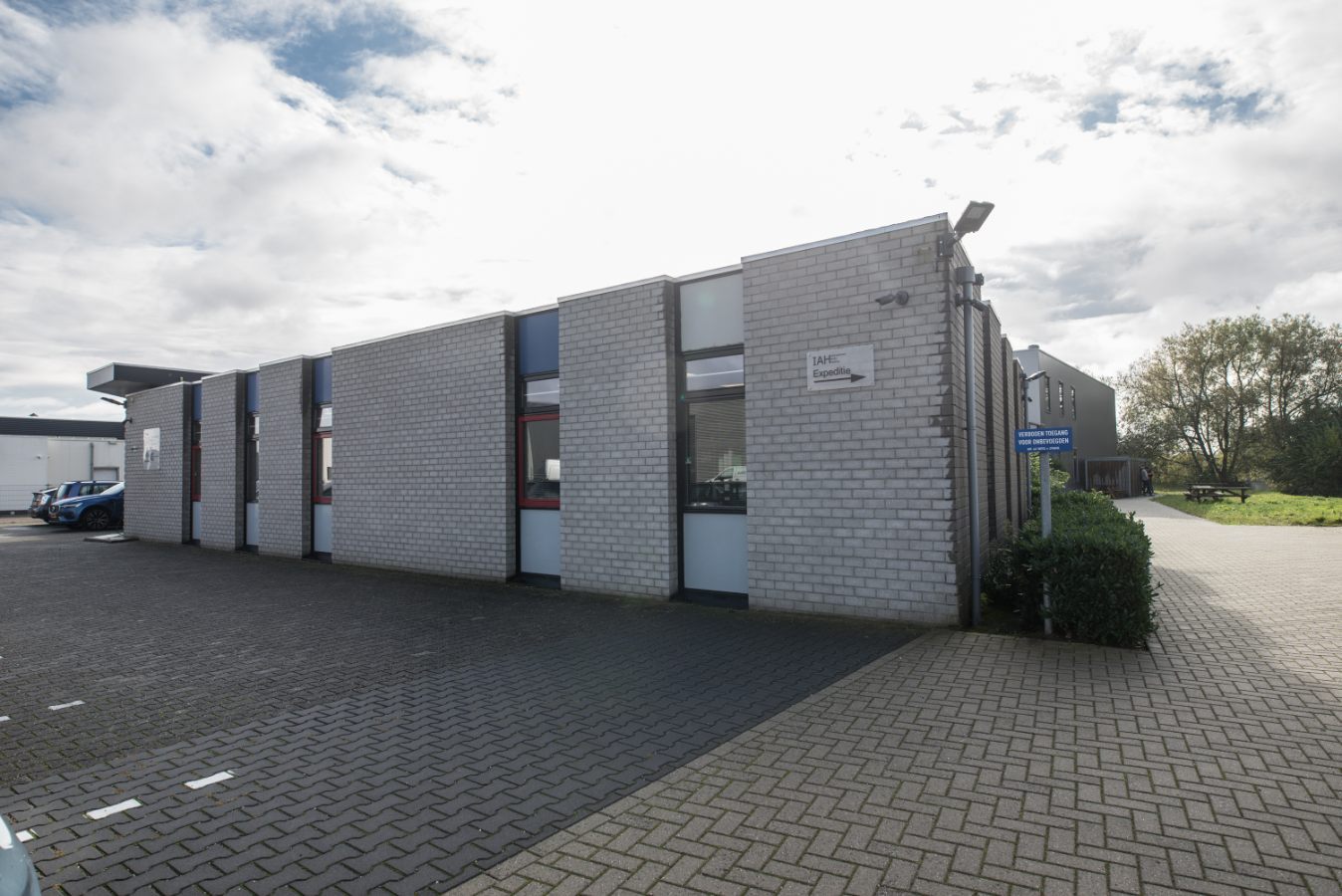

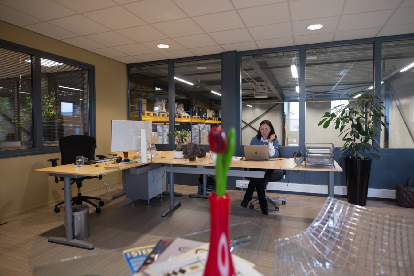

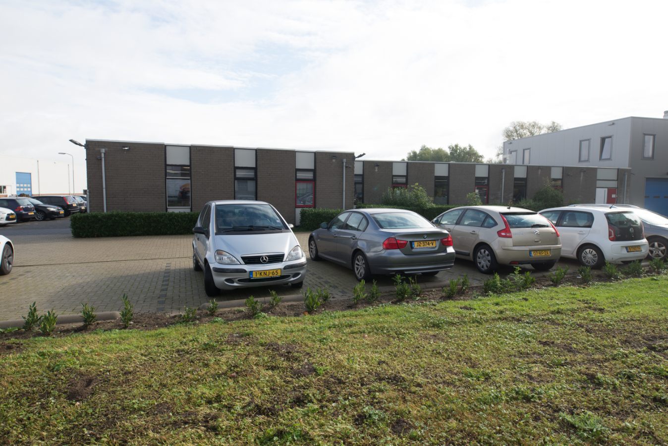

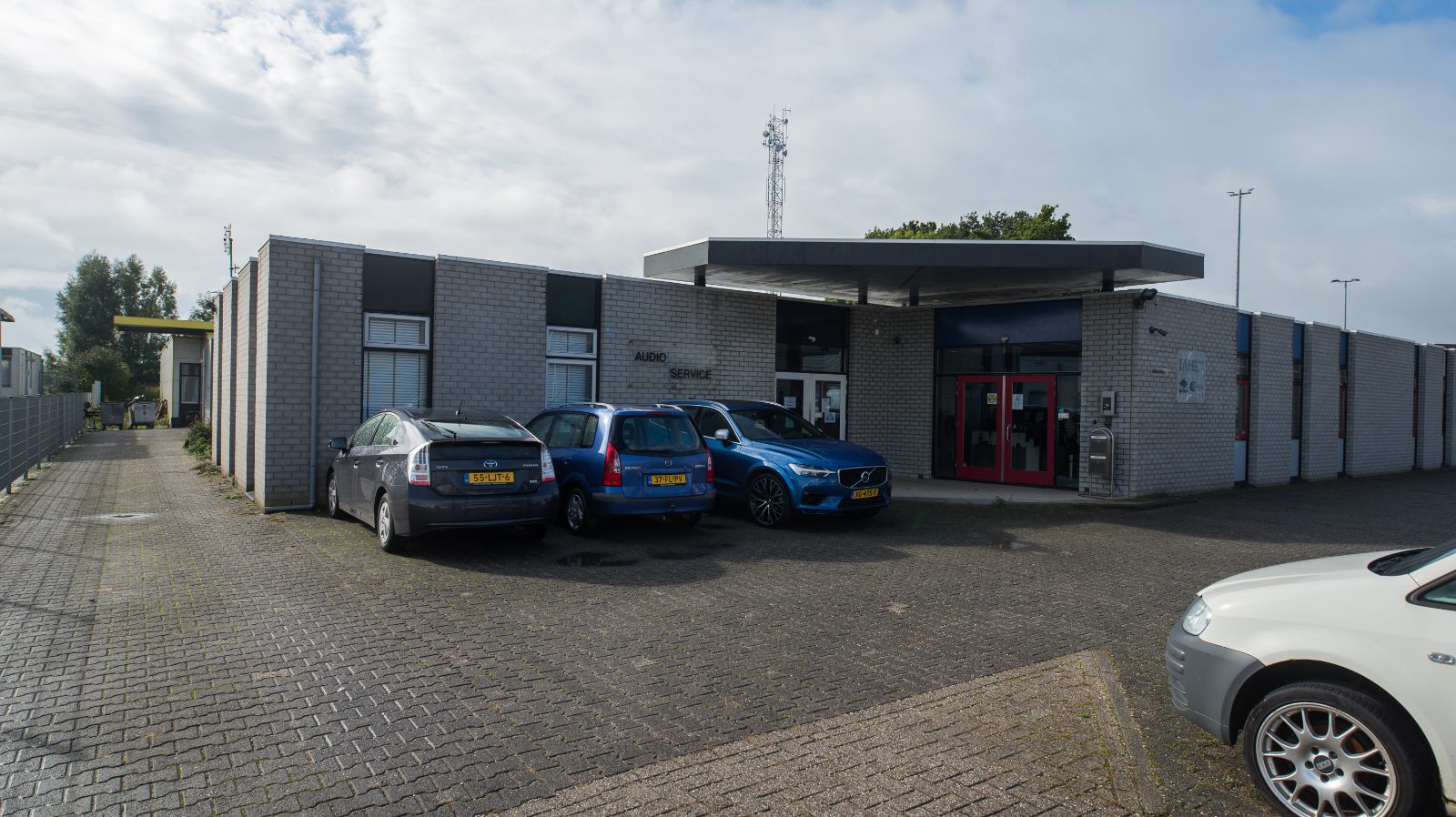

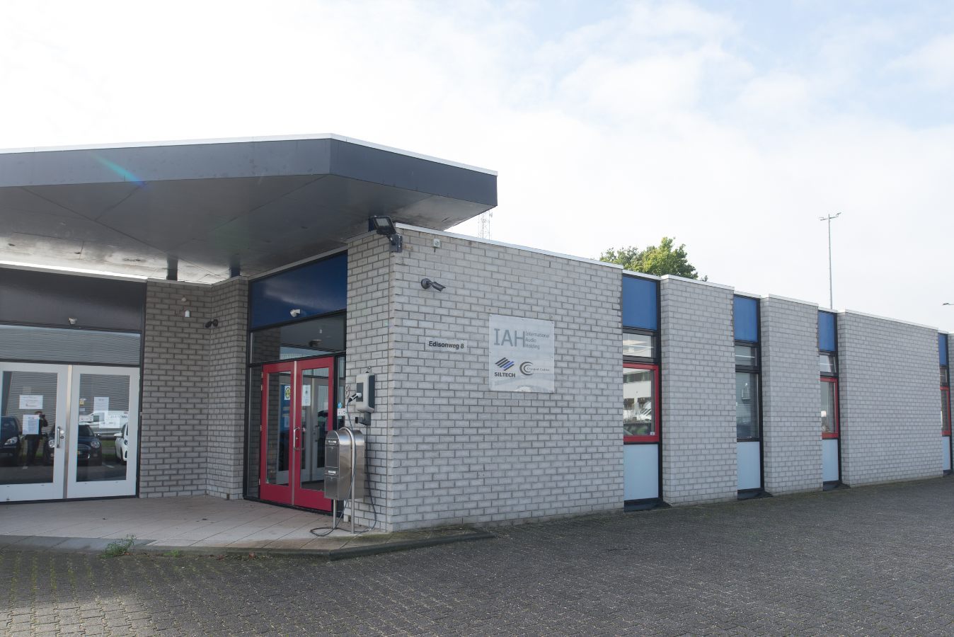

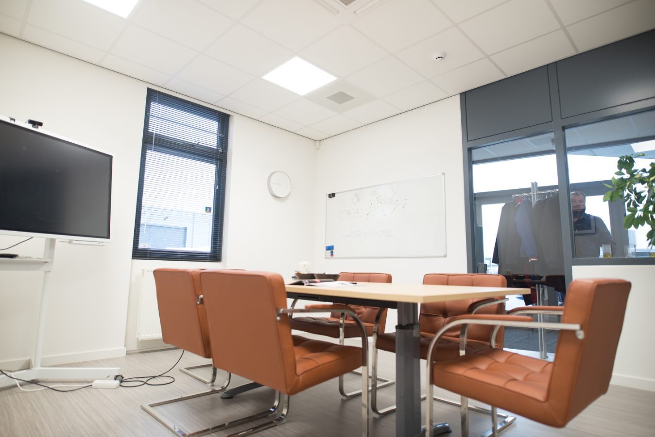

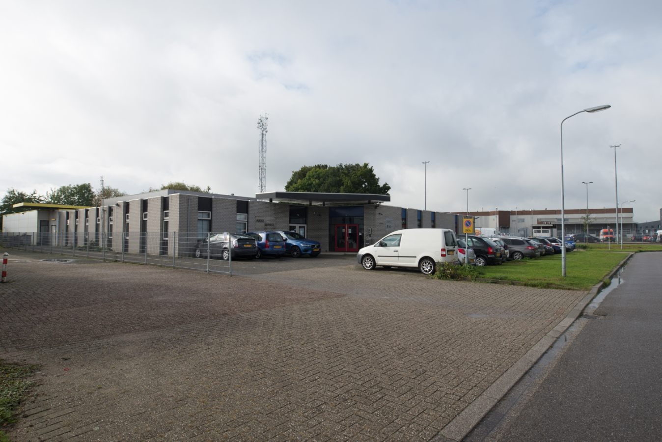

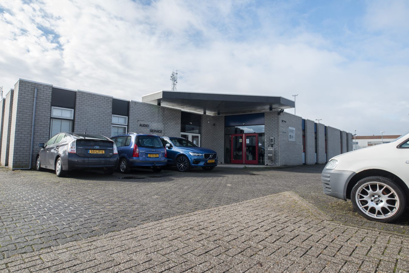

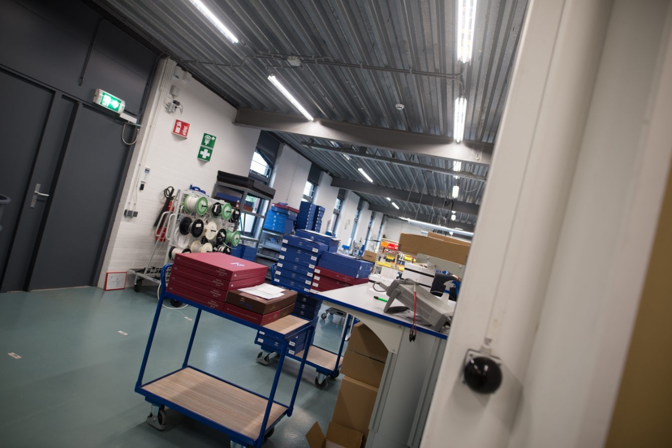

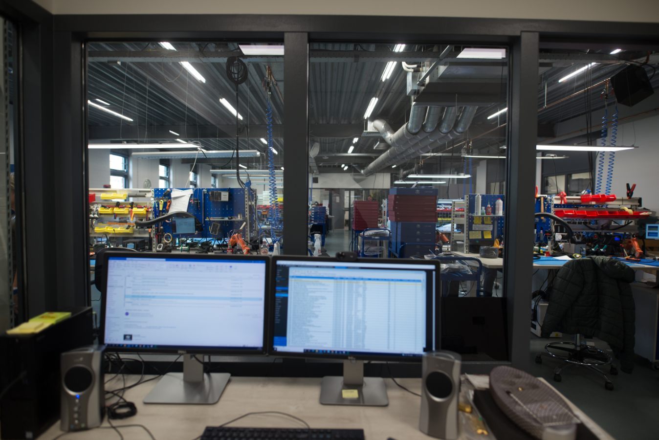

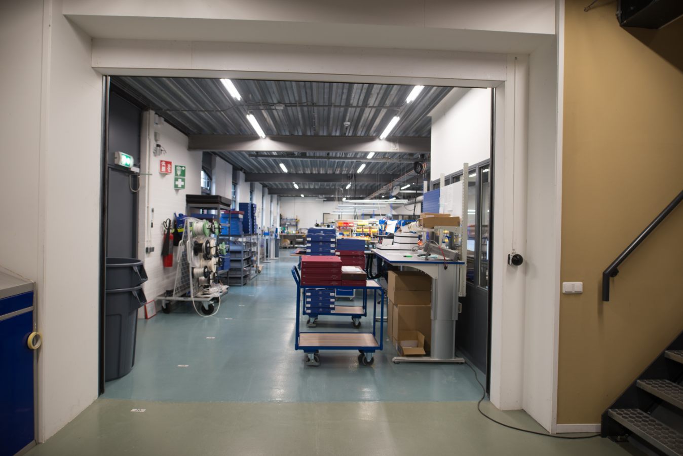

The Siltech plant is located within the agglomeration of the city of Arnhem, in the Netherlands. The two-story building with an area of approximately 1000 m2 includes a production hall, offices and a warehouse.

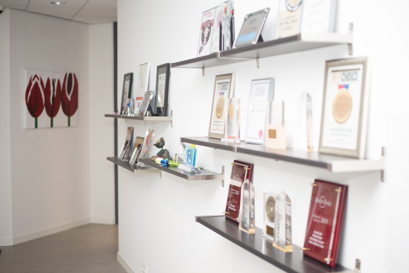

Right behind the entrance to the building, we see a wall of fame and a display case with numerous awards from around the world that Siltech has collected over the years.

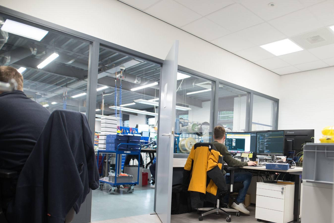

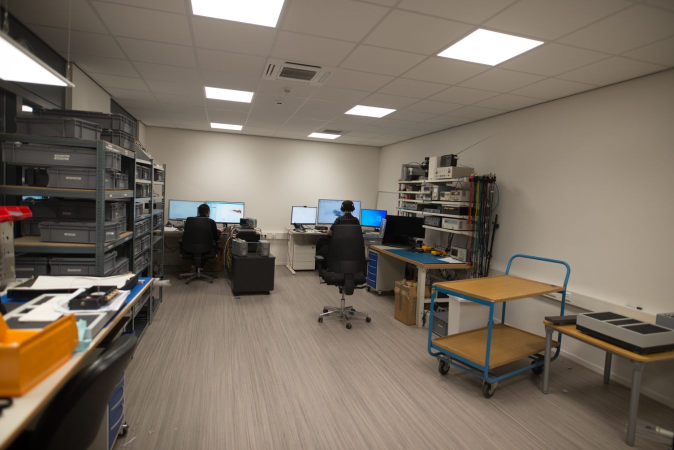

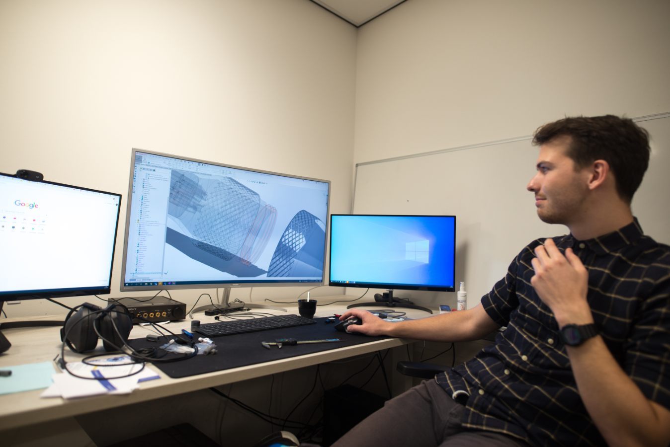

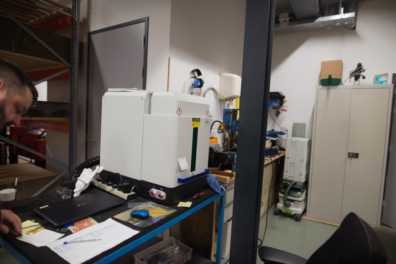

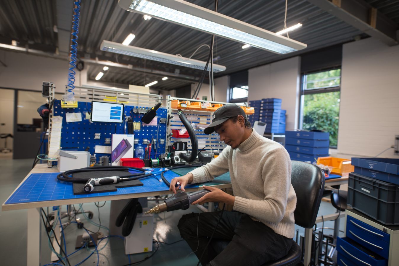

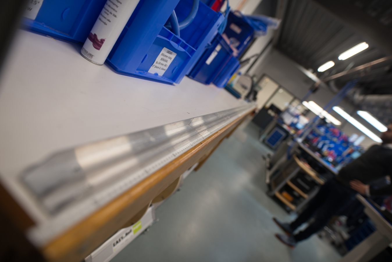

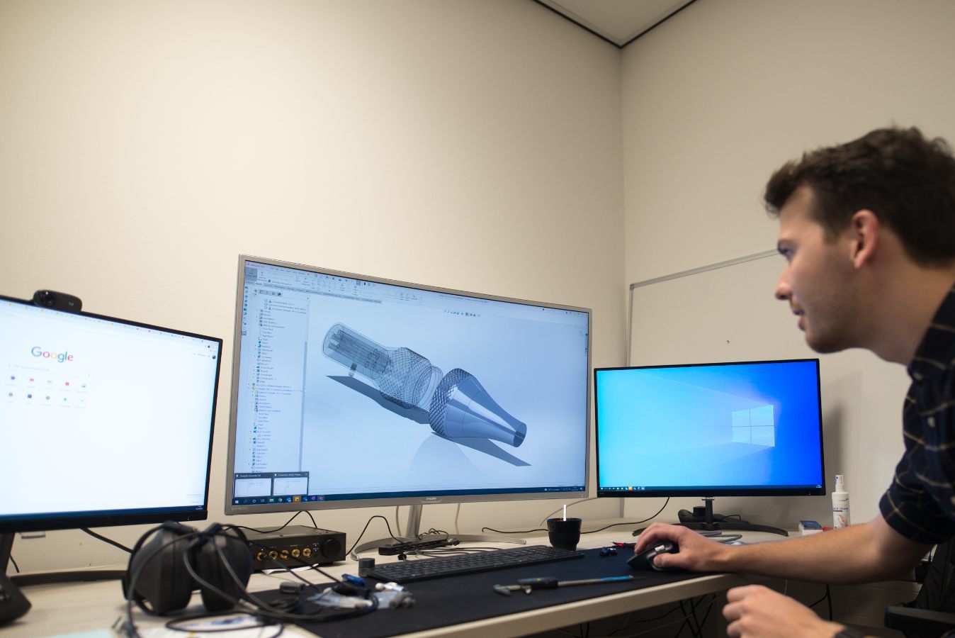

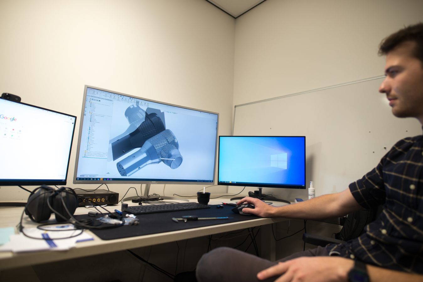

However, for us, the most interesting places are the rooms where the cables are produced. The process begins with the design phase, of course, everything is done with the help of modern software. A lot of information has been given to me, but of course some of the detailed information is the company's secret. In any case, already at the level of theoretical designs, individual types of cable strands, shields, insulation thicknesses and many other details are analyzed and simulated.
SiltechDSC2702.thumb.jpg.abca3bfeefe61320c72c066023f9ce06.jpgSiltechDSC2703.thumb.jpg.b8f9752b337f644cce1548f8b64fce32.jpgSiltechDSC2704.thumb.jpg.6b97665c95c40faf1778eabf28f4811c.jpgSiltechDSC2705.thumb.jpg.34e0c22ed0465a9caee1018396062873.jpg
SiltechDSC2698.thumb.jpg.f343cf07a0eaf878aeee2c10923dca1c.jpgSiltechDSC2722.thumb.jpg.ad5c9d8fea18f4c42557fcade9433dcc.jpgSiltechDSC2723.thumb.jpg.e9bfa2ad4c0f02d46dd1ed1c8ba7054c.jpgSiltechDSC2731.thumb.jpg.51daade4bcbbc15708c68269bd9461d7.jpg
SiltechDSC2674.thumb.jpg.008beff4da41264c88e479bb03afca4b.jpgSiltechDSC2675.thumb.jpg.f5556b0f85b35b28e5751242b9696654.jpgSiltechDSC2677.thumb.jpg.7361934afcdc0ba148d91a6dcdc1c793.jpgSiltechDSC2680.thumb.jpg.3c61a2d1447f2048994987d9b80a915f.jpgSiltechDSC2683.thumb.jpg.ba4e89f94f24d56f13d0ea564d742886.jpgSiltechDSC2684.thumb.jpg.1512348f355596dbf5e2a7670401de3e.jpg
SiltechDSC2694.thumb.jpg.2002819ddacc126bf9ea1096fef23ee2.jpgSiltechDSC2695.thumb.jpg.84f54912f9b8662818033f27ba1cb95c.jpgSiltechDSC2696.thumb.jpg.005f2ad23ff0f89263c7acca2a83b51c.jpgSiltechDSC2699.thumb.jpg.2ee61d232ea5d3aefc2ea6aa13679ff6.jpg
SiltechDSC2700.thumb.jpg.bed4df43648051b51097b2b2eb5d2e7a.jpgSiltechDSC2701.thumb.jpg.b12e864e74e93ff7886a7f22bc12e1a1.jpg

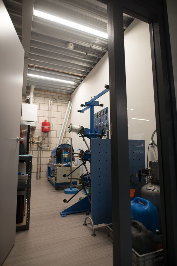

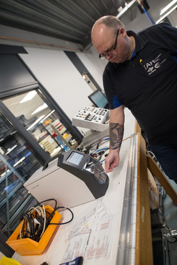

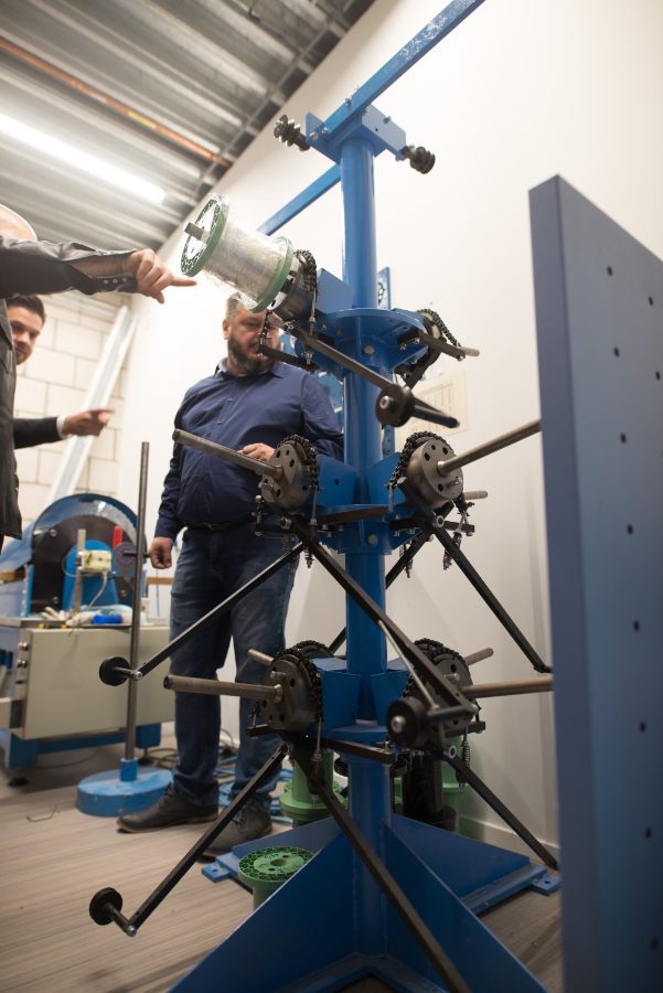

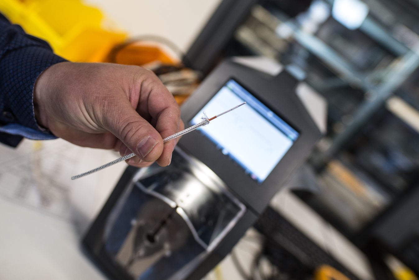

When the product goes into production, the appropriate machines twist the given windings from the appropriate amount of wire rope - made of pure silver. Insulation is made of polymer-based materials, besides having optimal properties desired from an electric point of view, it is characterized by remarkable resistance to mechanical damage.

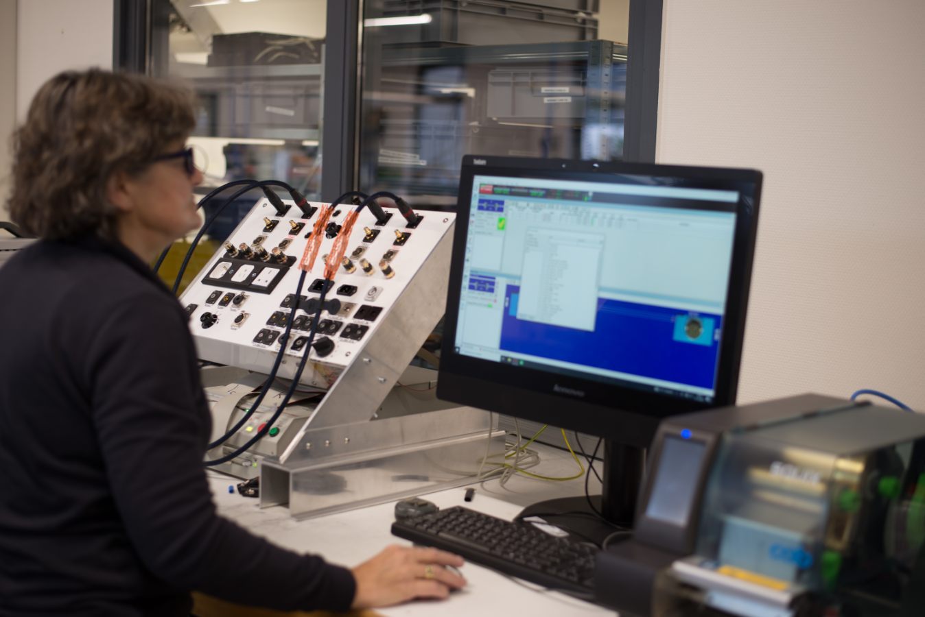

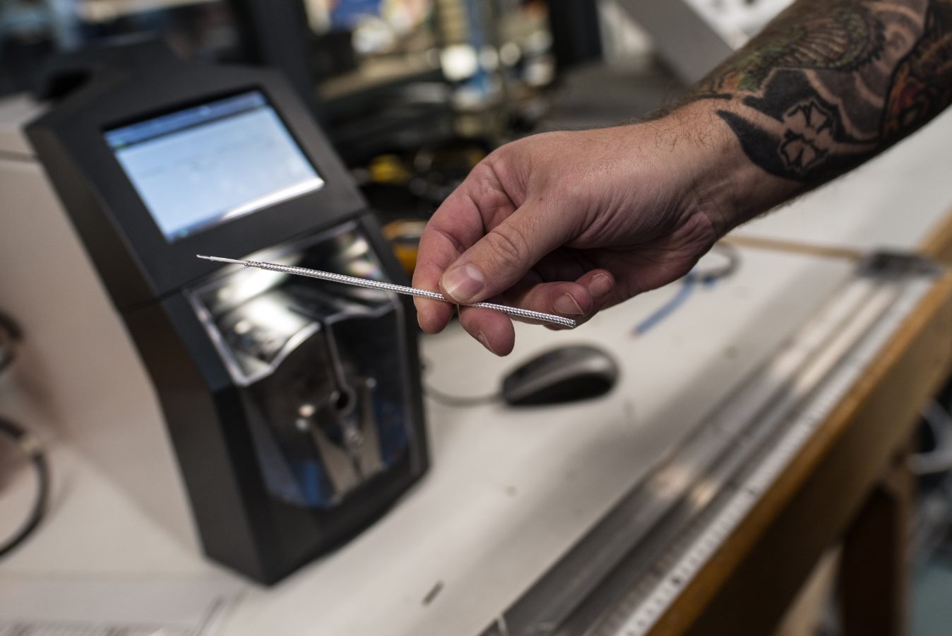

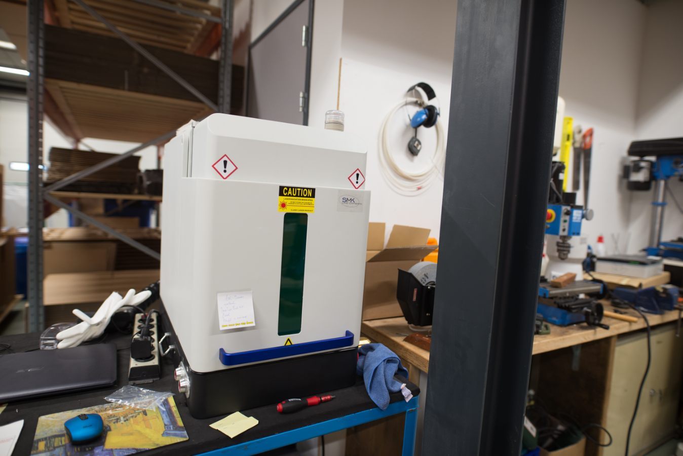

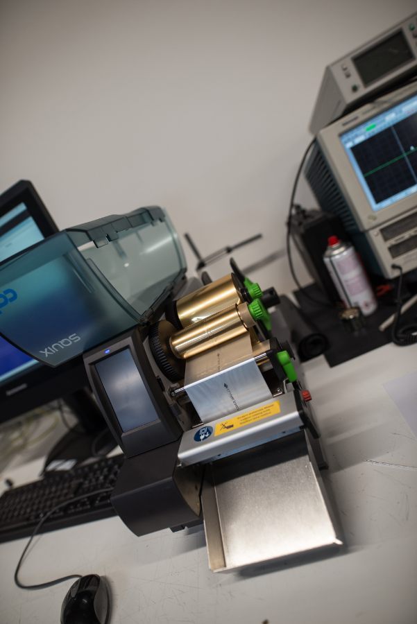

The finished cables are then properly connected and confectioned. Removal of a given amount of insulation is done by an appropriate machine that has several dozen saved programs - for each cable produced. After selecting the appropriate program, just insert the end of the cable into the appropriate hole and all layers of insulation and shields will be automatically stripped - each to a different length. Thanks to this, even single wires of the screens are not damaged, as well as thin layers of internal insulation - if this was done manually with guillotines or knives, it would not be possible to avoid it. The next step is to mechanically unfold the screen wires - you can damage individual wires by hand and touching them with your hand greases them, which may make soldering difficult.
SiltechDSC2691.thumb.jpg.7a79eadb6b3a4be417012537b406c709.jpgSiltechDSC2693.thumb.jpg.d2a0108dcb47b2f8873415a5125a640d.jpg
Even such a simple operation as unwinding cables from a spool of several dozen meters is automated, and it is not about speeding up the work (because the machine does it longer than a human), but the point is that the cable that lies on the spool for a longer time forms in the shape of a circle and to fully straighten it, the unwinding machine heats it to the correct temperature and stretches it. As a result, the cables do not have a natural tendency to curl.

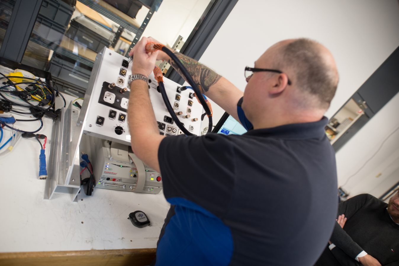

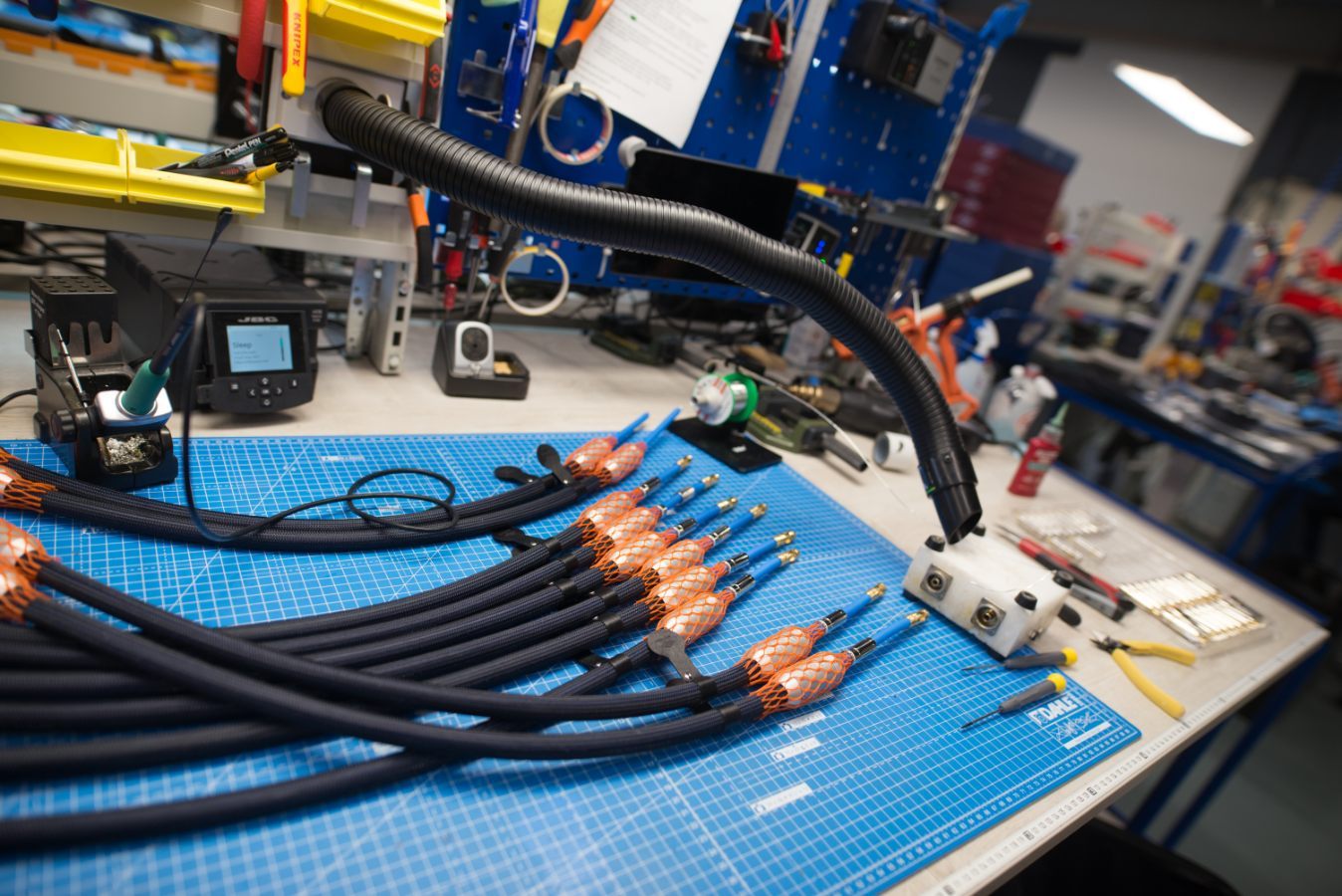

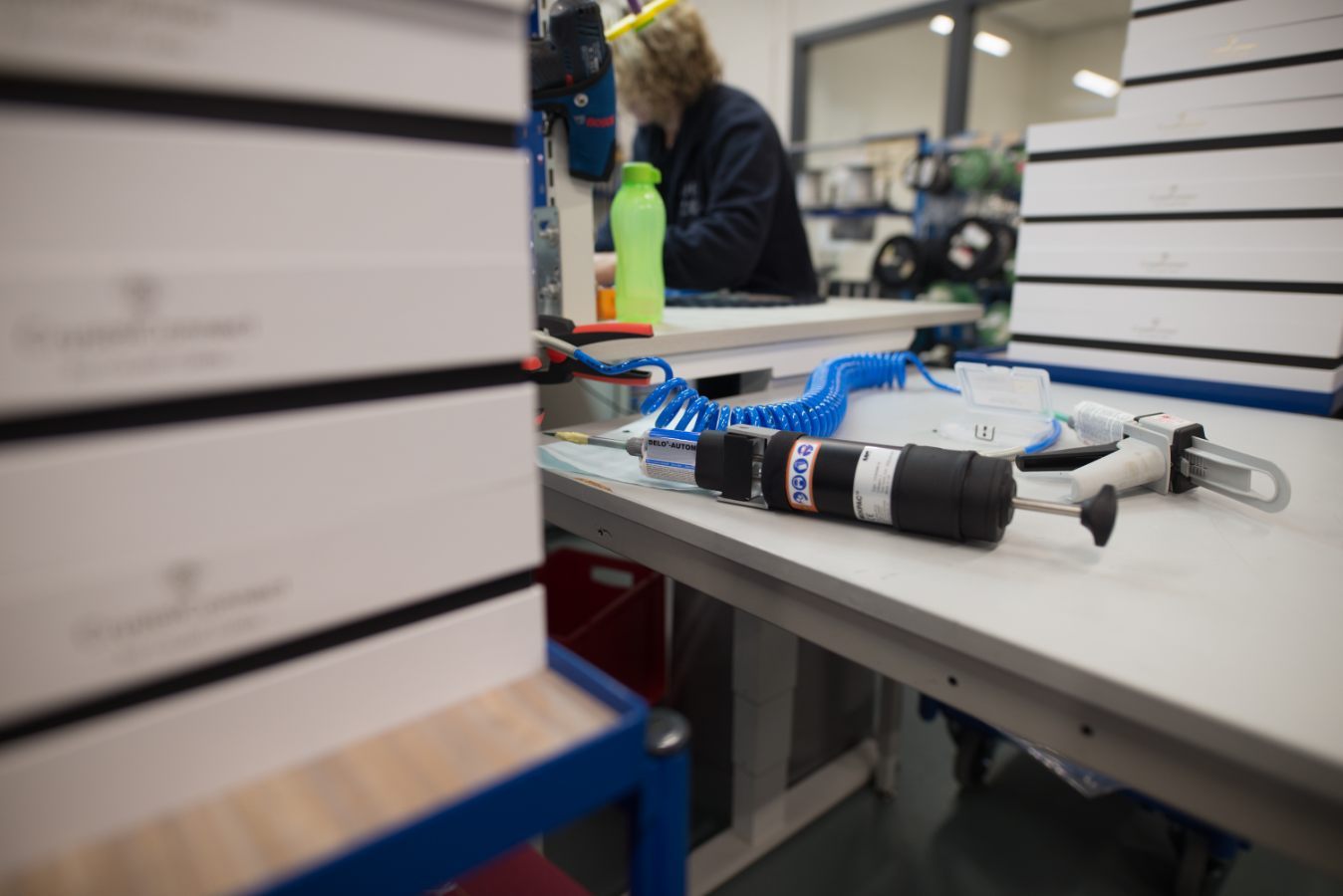

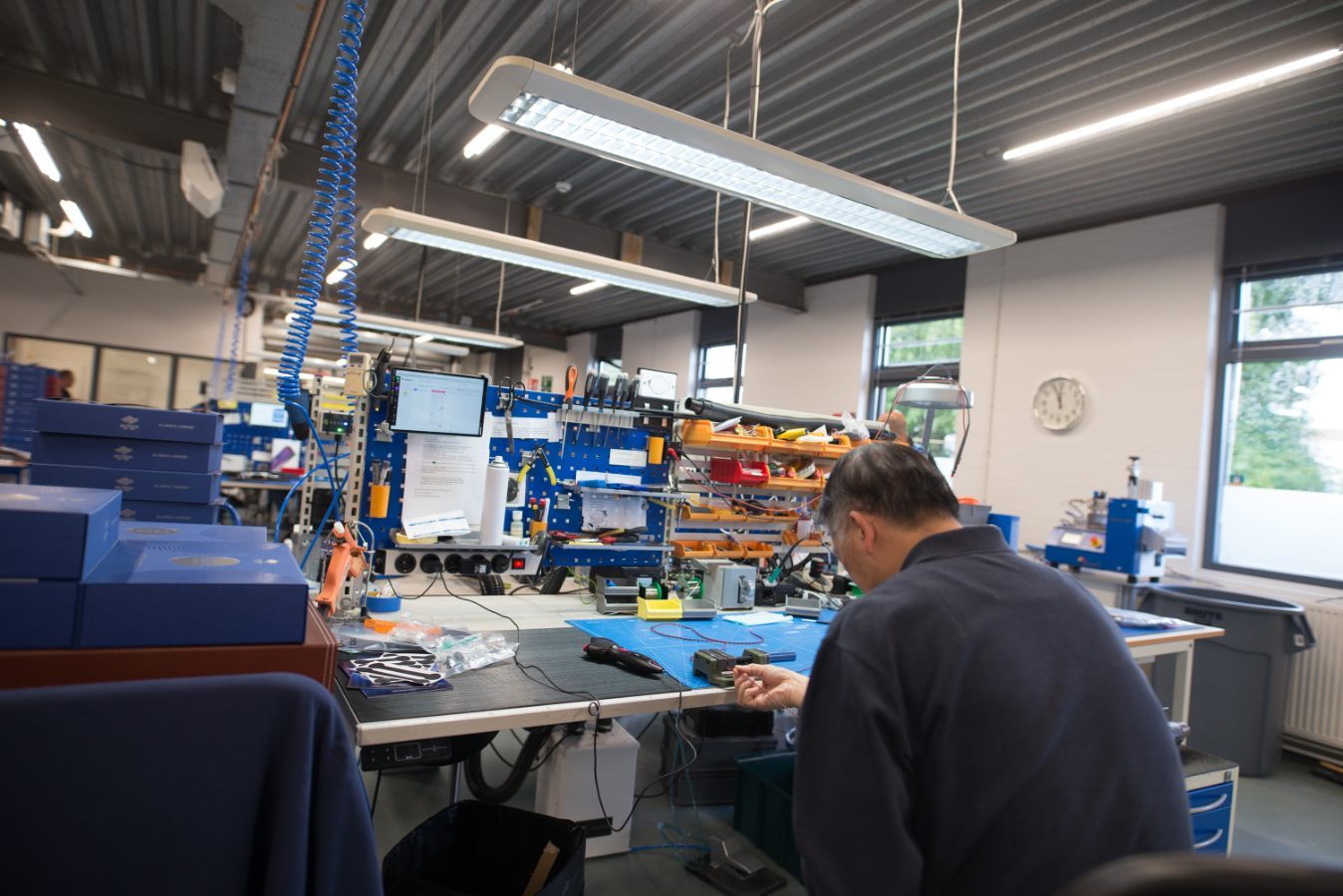

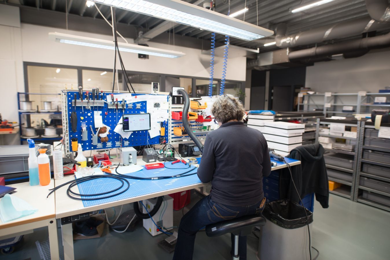

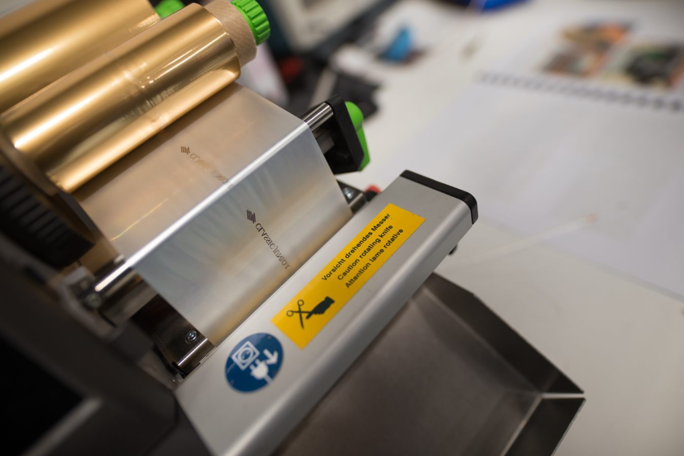

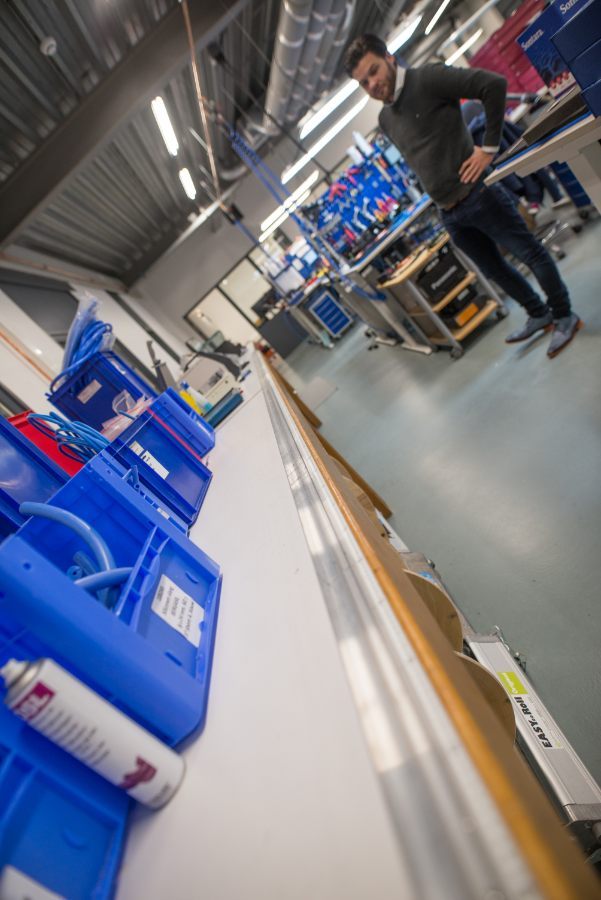

When the cables are already prepared and soldered, the fully manual work of assembling the boxes, braids and soldering the plugs begins. It can be safely assumed that the production of only one cable takes several hours of work. More than a dozen assembly stations work non-stop, which is barely enough to meet the market demand.
SiltechDSC2794.thumb.jpg.e1284de0e258586faacab4bf3845a102.jpgSiltechDSC2809.thumb.jpg.d2769637af97a97b4d2336031b450662.jpg
SiltechDSC2729.thumb.jpg.96d7aa935c9122380737fee216a70aa4.jpgSiltechDSC2730.thumb.jpg.993f70d3488a3e5c2d705e45349cae35.jpg

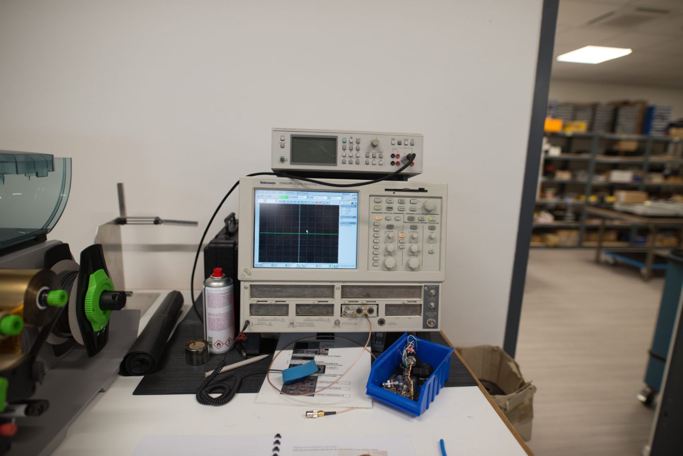

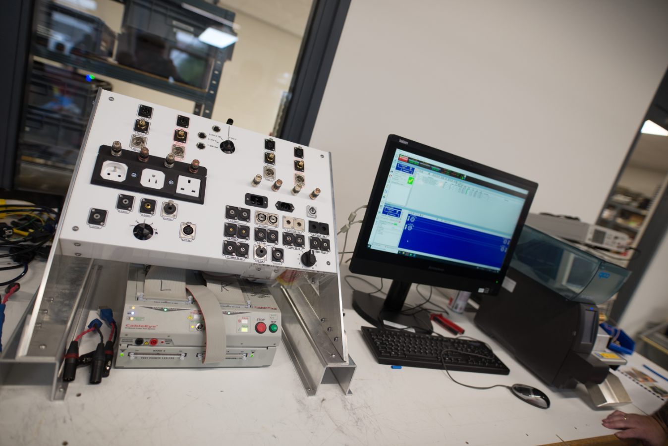

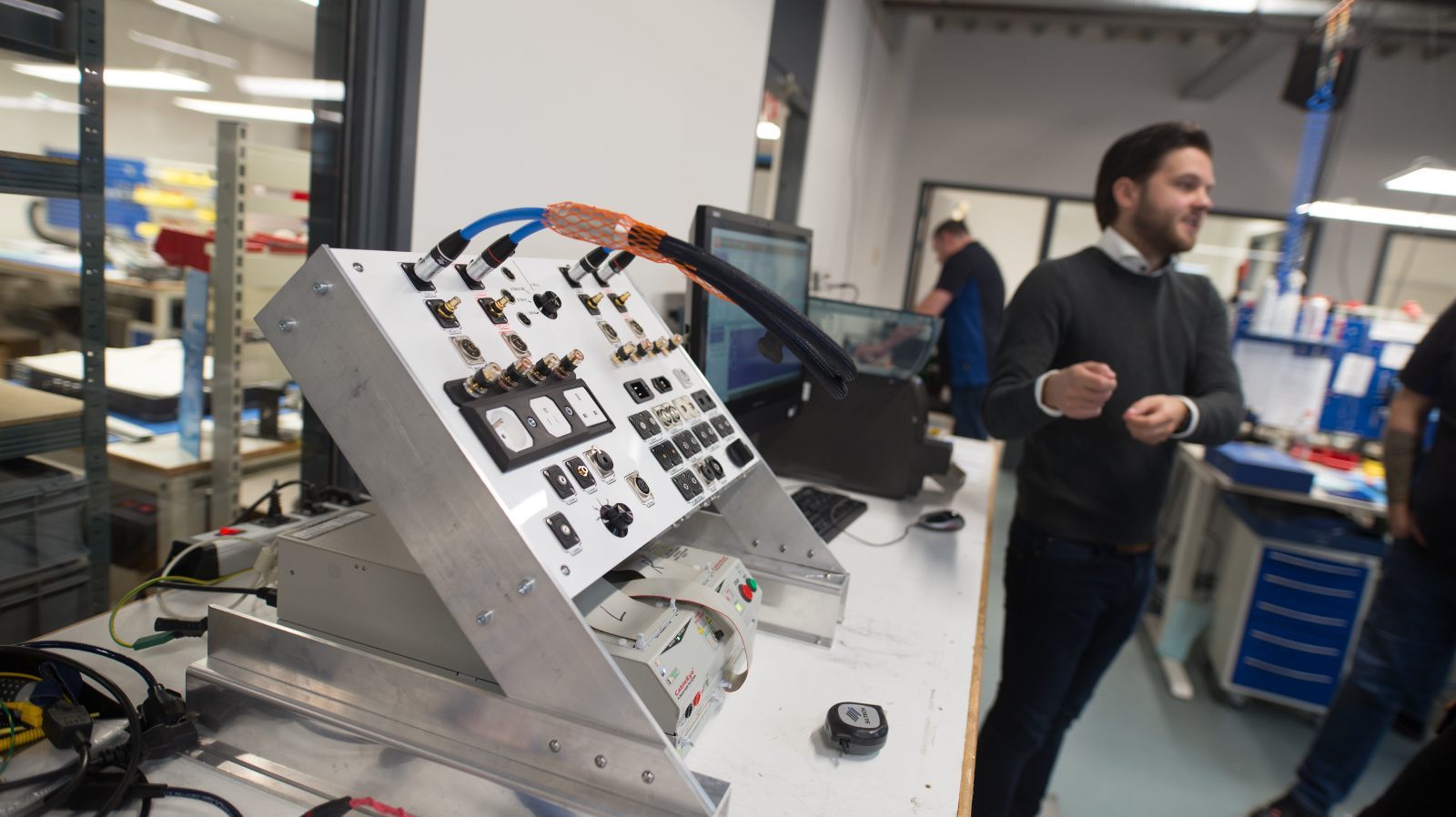

The finished cable is tested with a special test device. Again, select the template saved for a specific wire and an automated test procedure is launched that runs a current of different intensity and voltage several hundred times to test the wire. Even signal cables with operating voltages of a few single volts are tested with voltages above 1000V, which translates into the first cable formation process. For signal and loudspeaker cables, the test checks the error tolerance of the left and right cables to ensure that the cables are indeed a pair. At least a dozen different electrical parameters are tested, for example differences in resistance tolerance appear only in third place after the decimal point ... Cables with such parameters could successfully serve as test leads of precise resistance meters.

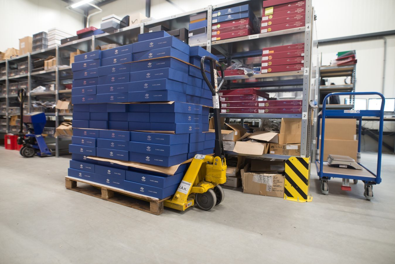

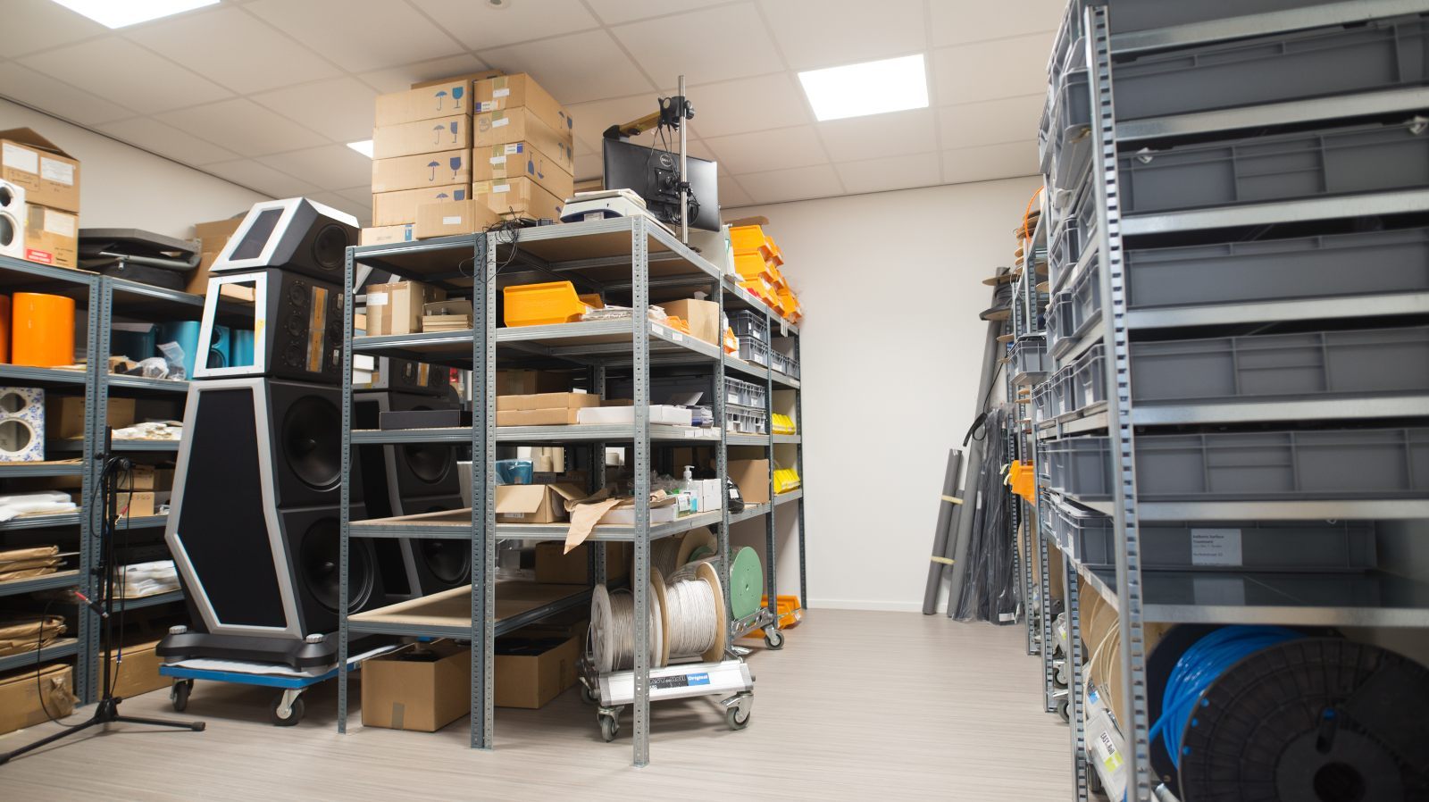

Cables made and checked in this way are then packed and sent to the dispatch warehouse. This is where the product's path in the factory ends and its life in audiophile systems begins.
SiltechDSC2654.thumb.jpg.7dd54535dfd7bb15d4b8da666b976912.jpgSiltechDSC2666.thumb.jpg.3333a6bd7e934f4ad57d4de68d04fd9d.jpg
SiltechDSC2725.thumb.jpg.878efdd6687a4495a698f2b4753a5f64.jpgSiltechDSC2733.thumb.jpg.c5aec04c4b88f619d4fdd3b40f7a92e1.jpg
SiltechDSC2735.thumb.jpg.92df85ff51d8133a8f6d58493a59aa79.jpgSiltechDSC2736.thumb.jpg.f86926393a266895aa63ede22e63e42a.jpg
SiltechDSC2743.thumb.jpg.5127f52e6c79ed16acad4130fe3168b3.jpgSiltechDSC2744.thumb.jpg.1345c18410294d420754bee8400f7cd7.jpg
